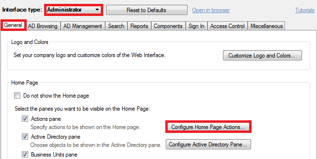

There is no such possibility using the Remove from Group Home Page Action. However, you can use the Modify Group action and customize the action form to include only the Member section. For information on how to create the Home Page Action, have a look at the following tutorial: https://www.adaxes.com/tutorials_WebInterfaceCustomization_ConfigureActionsPane.htm.
by (870 points)

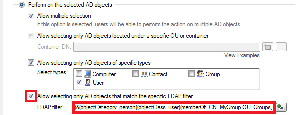

To be able to search only among members of a specific group when using the Remove from Group action, you need to edit the action to use an LDAP filter for target object selection. To do so:

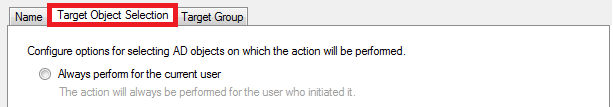

  3. Double-click the action.
  4. Activate the Target Object Selection tab.
  5. Select Allow selecting only AD objects that match the specific LDAP filter option.
  6. In the LDAP filter field, specify the following:
    (&(objectCategory=person)(objectClass=user)(memberOf=Group_DN))
    where Group_DN is the distinguished name of the group you want to remove users from.

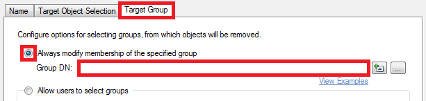

  7. Activate the Target Group tab and select the Always modify membership of the specified group option.
  8. In the Group DN field, enter the distinguished name of the same group that you specified in the LDAP filter field on step 6.
  9. Click OK three times.
