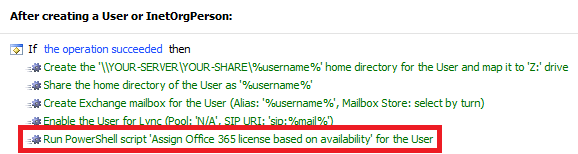

Yes, there is. You need to use a script for this purpose. We've added a sample script that does the job to our Script Repository: Assign Office 365 license based on availability.
If you are assigning licenses automatically, for example, using a Business Rule, replace the Activate or Modify Office 365 account with the Run a program or PowerShell script action that runs the script from the repository.
If you want to assign the licenses manually, you can create a Custom Command that runs a script for this purpose.
