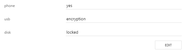

we want to pull a simple small data set for a user from a database, store it in an custom attribute and then display it to the users via the we front end
EG:
phone yes
usb encryption
disk locked
is there anyway to do this? currently we use a customtextmultivalue but we cant store any formatting in there so the table becomes a mess
by (300 points)
Unfortunately, there is no possibility to display the date the way you want. As an option, you can save each value (yes, encryption, locked) to separate custom text attributes (e.g. CustomAttributeText1, CustomAttributeText2 and CustomAttributeText3) and change the attribute display names accordingly. Finally, you will have something like the following: image.png
thanks, yes we can do this, but we dont know the contents of the table, the fiellds and values are unknown and the data returned could be 1 line or 10
Thank you for clarifying. Unfortunately, there is no other way.
