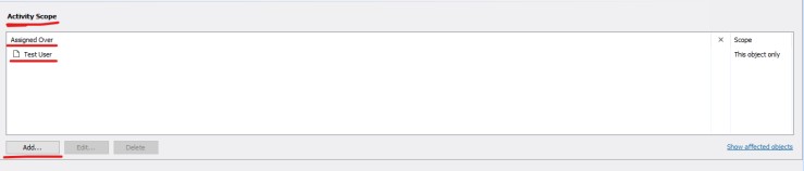

Thanks for the response. I am not sure you understood my question fully.
My question is that i want to remove the userx.txx / .csv file completley. I want the script to run against the user i specify in the ADAXES activity scope, as shown below.
That is exactly what we meant. When the script is executed, it will be done separately for each user in the Activity Scope. As such, at each execution, the user will be the target object. There is no need to do anything specific for that to work. At the same time, the approaches we suggested provide information on obtaining information on the target user in the script itself. The following SDK article might also be helpful: https://adaxes.com/sdk/CloudServicesScriptContextClass.
Ah ok, understood. Thanks so much for your help.

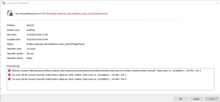

Hi, i am now getting an error on the Reset MFA step. It states i need to connect to AzureAD, which makes sense, however using the command $Context.CloudServices.AzureAD() gives me the error(s) shown in the screenshot. Thanks for any and all help. image.png
First of all, the AzureAD PowerShell module is deprecated and you should not use it. You should do the lot via MgGraph. For an example, have a look at the following scripts from our repository: https://www.adaxes.com/script-repository/sign-out-from-all-microsoft-365-services-s597.htm. For your information, $Context.CloudServices.AzureAD() just does not exist.
