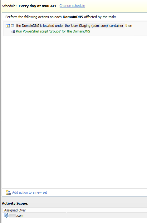

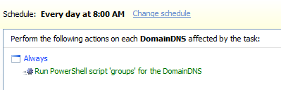

The Activity Scope shows nothing. I included the text as it appears in our script.

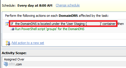

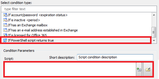

As we can see, you have added the If located under condition to the Scheduled Task. Domains are not located under any OUs, thus the task does not get executed. Remove the condition and try running the script again.
If you need to include only users from a specific OU into the report, we will update the script for you.

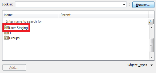

Yes we would want only the OU listed in the screenshot to be searched.

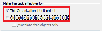

Thank you for clarifying. You need to create a Scheduled Task configured for Organizational Unit Object type. No conditions need be added to the task. To create the Scheduled Task:

  7. Click Add on the Activity Scope page and double-click the User Staging OU.
  8. Important: Select only This Organizational-Unit checkbox.
  9. Click OK twice and finish creating the Scheduled Task.
