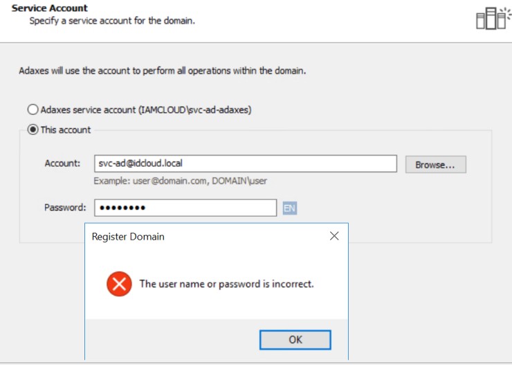

hello, We are doing poc for Adaxes software. Our need: Adaxes as front end to manage multiple isolated domains with no trust e.g. Domain A, Domain B. We deployed Adaxes Service on a server which is member of domain A. Domain A shows as managed. Attempt to add Domain B with a domain account created in domain B always gives error "User or password is not correct". Is this toplogy supported

Since its a poc setup, all servers are in same L2 network with no firewall in between three servers. Anything else i can check. I tried to use account with enterprise admin priviledges of domain B to add it as managed domain still get error. I below screenshot Domain A = iamcloud.local Domain B = idcloud.local
Are you sure that all the ports are open from the computer where Adaxes service is installed towards the domain controllers of the domain you are failing to register?
When the username and password are actually correct (you can use them to sign in to AD), the only option for the error to occur is something blocking the authentication. It can be firewall or some protaction software in your environment. There is just nothing in Adaxes that can cause such a thing.

Please, execute the below script in Windows PowerShell ISE on the computer where Adaxes service runs and provide a screenshot of the output. You can post the screenshot here or send to us at support@adaxes.com. In the script, you only need to specify the password.
$username = "svc-ad"
$domain = "idcloud.local"
$password = "secret"
[Softerra.Adaxes.Utils.NetworkCredentialHelper]::LogonUser(
    $username,
    $domain,
    $password,
    [Softerra.Adaxes.Interop.LOGON32_LOGON]::LOGON32_LOGON_NETWORK,
    [Softerra.Adaxes.Interop.LOGON32_PROVIDER]::LOGON32_PROVIDER_DEFAULT)

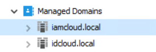

I just found this and this resolved my issue
https://www.adaxes.com/questions/12723/managed-domain-trusted-primary-domain-adaxes-installed-running
