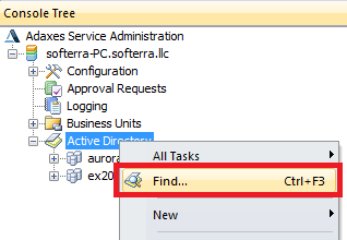

Yes, this is possible with the help of Adaxes Administration Console:
  2. Expand the node that represents your Adaxes service.
  3. Right-click Active Directory and click Find...

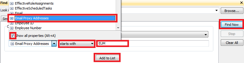

  4. In the Find dialog that appears, switch to the Advanced Search tab.
  5. Select User in the Type field.
  6. Open the property selection drop-down list and select Show all properties.
  7. Select Email Proxy Addresses and starts with.
  8. Type the name of the alternate proxy address type (for example, EUM or SMTP).
  9. Click Add to List.
  10. Click Find Now.
Perfect. I found that it works better if you use "contains" "Joe_Normal" as the filter "starts with" must be used like this "smtp:Joe_normal".
It seems that I just misunderstood your requirements a bit. I thought you wanted to search for mailboxes with a certain address type, like SMTP or EUM. If you were searching for a specific address, then, of course, you need to search using the contains logical operator.
