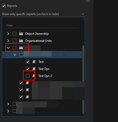

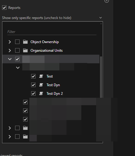

  1. I created a container for our helpdesk and adding reports there. Each time a new report was added, I need to manually select either the report or the whole cointainer again, so it is visible for the team. Any way to auto enable reports under a certain container?

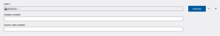

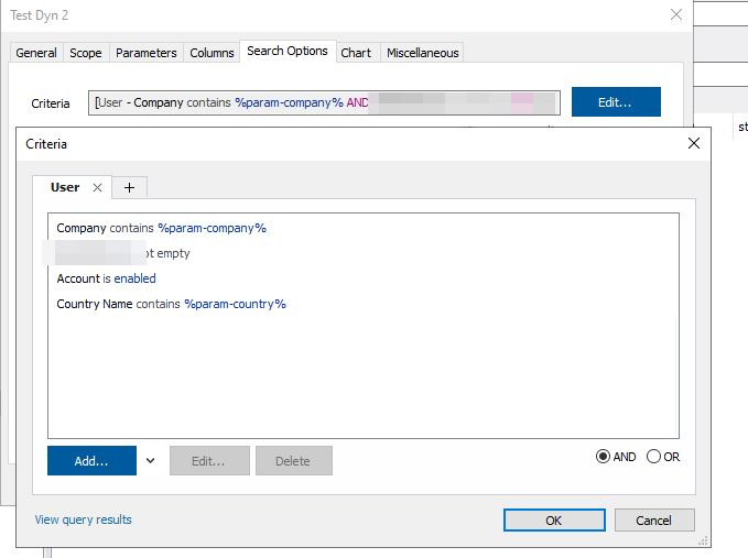

Now I want to achieve the following
  • Adding own pre defiend values like "AT", "DE", "PL"
  • Based on selection, the company and country name should be set
  • For example, I select "DE", then country name should be Germany and company name should be MyCompany
Is that possible?
I have this "dynamic" report with parameters
Unfortunately, there is no such possibility. However, we have the feature in our plans for future releases. As a solution, you can use a script to generate the report and have just a single drop-down list parameter. All the dependencies will be specified in the script. Unfortunately, we do not have anything like that in our repository, but the following article should be helpful: https://adaxes.com/sdk/GeneratingReports.
