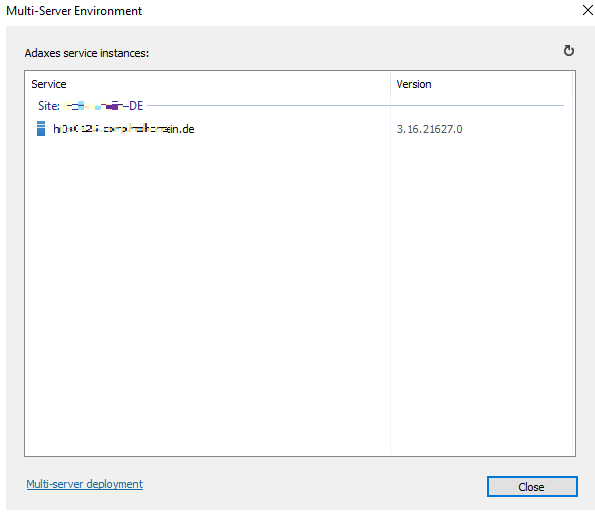

Hello Boris,
Thank you for the provided example. For us to write a script that will generate the report, please, provide us with a screenshot of the Multi-server environment dialog. The dialog displays how many Adaxes services you have and what their versions are. For information on how to view it, see https://www.adaxes.com/help/MultiServerEnvironment. You can post the screenshot here or send to us at support@adaxes.com.
by (570 points)
we have only one instance running: image.png
thanks for your support

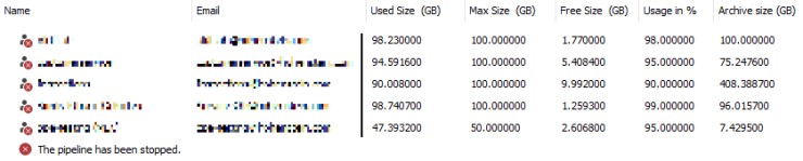

Hello Support,
Thank you very much for the time and effort you have invested, the script fulfills my requirements perfectly. :) Unfortunately it is stopping with "The pipeline has been stopped", after some minutes I have set the scope to "specific location" and "direct children", which contains ~200 Mailboxes. Any thing else I could do, to avoid the error?
by (307k points)
Hello Boris,
The error occurs because executing the script takes longer than 10 minutes which is the default timeout. You can change the timeout, but it can only be done for all scripts.
