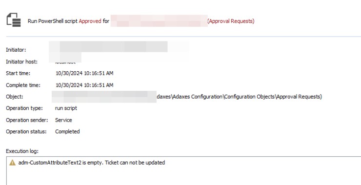

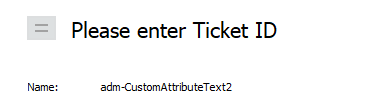

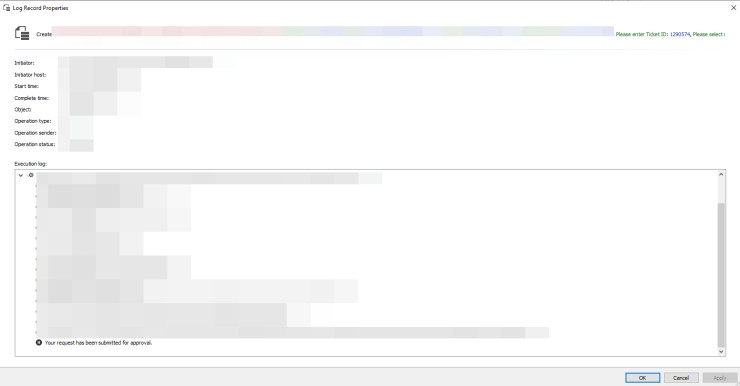

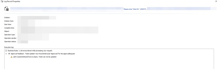

According to the screenshot, the target object of the operation that was submitted for approval has adm-CustomAttributeText2 empty, hence the warning. You need to make sure that the property is not cleared somewhere between group creation and the script execution.
