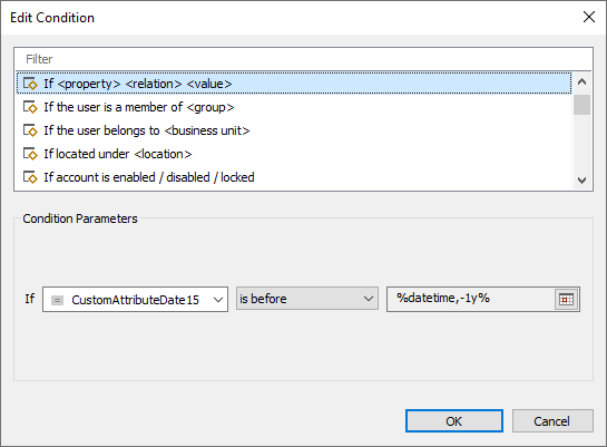

There is actually no need to use scripts. You can use the If <property> <relation> <value> condition in a custom command, business rule or scheduled task: image.png
I tried this and it didn't seem to work. For clarification, I was using a timestamp at first, must it be a date field instead?
It does not matter, the condition will work fine for both. If you face issues, please, describe the exact desired behavior and provide screenshots of your configuration.
Let me do some more testing to triple check it did not work as I expected. I certainly could have misapplied the time comparisons.
I've confirmed that works. Thank you.
