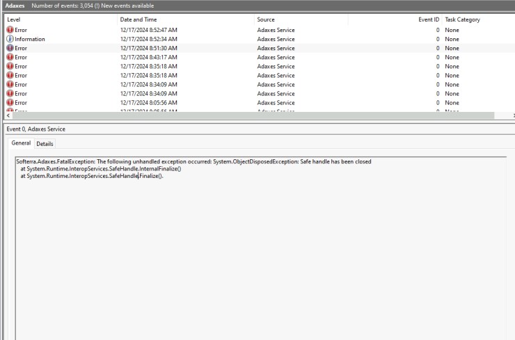

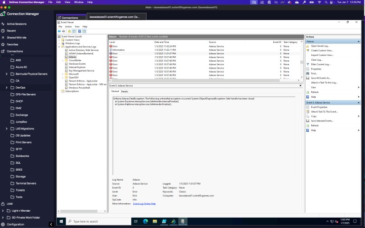

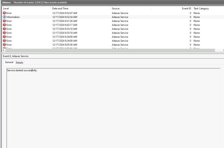

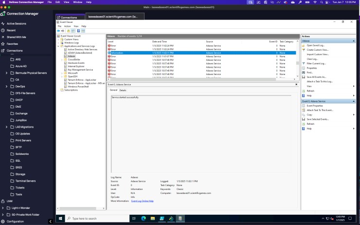

We have been using Adaxes for a couple of weeks now. We have observed that occassionally the Softerra Adaxes Service errors out and the service stops working. This usually requires us to login and restart the service to resolve the problem. Ocassionally the issue has been able to correct itself after some small downtime. Can we identify why this happens to being with? I have shared some screenshots of the logs when the service errors out and when it resolves itself.

I have sent an email a couple days ago regarding this. I messaged Serge via email regarding this and shared the event logs. The issue happened again on Sunday night The event logs indicate a fatal error exception and then the service restarting a minute afterwards.
Is there any other information I could provide for this. The service seems to hit this fatal error once every couple of weeks and causes the service to restart.

It is hard to see the text in your screenshots (the text is unreadable), but according to the general view, there were no such errors in the Event log you provided.
