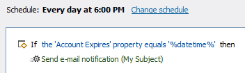

Do we understand correctly that the email should be sent on the expiration date? If that is correct, you can use a scheduled task like the following: image.png

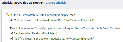

Thank you for specifying. As the updates are made omitting Adaxes, the only option is to preserve the current expiration dates and then use a comparison in the scheduled task. For the preservation, you can use any of Adaxes custom date attributes (e.g. CustomAttribtueDate1). Finally, you should have something like below. image.png

Hi again and thanks for your quick reply,
Will this ensure that we will not receive another e-mail for the same user the next time the scheduled tasks runs?
We only want one e-mail per user if the value is populated.
by (306k points)
+1
Yes, that is exactly it. Every time the Account Expires property changes, a single email will be sent.

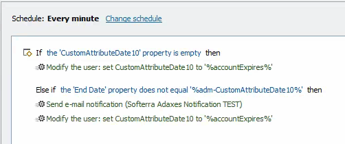

The scheduled task is configured like this:
FYI: We have changed the "Property Display Names" of "accountExpires" to "End Date", and we have used the attribute "CustomAttribute10" instead of "CustomAttribute1" due to it being used someplace else in our setup.
Skjermbilde 2025-01-20 140735.png Do you have any other solutions on to how to resolve this issue, or do you think there's anything in our setup that prohibits this to work based on the information provided earlier in the post? We have several "Business Rules" that triggers e-mail notifications (set up just like this one) that still works.

First of all, you should never set scheduled tasks to run every minute. It is very resource consuming and will never actually work as the next run of a scheduled task is counted from the end of the previous one. In your case running once an hour or even once a day should be just fine.
The setup of your scheduled task is correct. As long as CustomAttribtueDate10 is cleared, the Send email notification action is also executed. How exactly do you check that it is not? Did you check the general log? Are you sure that the email address in the action is valid?

Hi again, and sorry for my late reply...
The reasoning for setting the task to run once every minute, was purely for testing purposes. We have also tried running it once every hour, but this did not change our outcome. The emails never showed up.
Yes, we based our findings on the general log. From there we could see that the "CustomAttributeDate10"-field was cleared, but there was no records (via general log) of emails being sent based on the previous action. All of our email-settings (including recipients) were copied from another working action.
