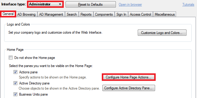

Yes, it is possible. The solution will include a group, a Scheduled Task and a Home Page action. The group will include only users that manage groups. The task will add/remove members from the managers group. The Home Page Action will allow managers to add new members only to groups they manage.
Also, you will need to allow access to the Self-Service Web interface only for members of the managers group.
For information on how to create the group, have a look at the following help article: https://www.adaxes.com/help/?HowDoI.Man ... Group.html.
For information on how to allow access to the Self-Service Web interface only for members of the new group, have a look at the following help article: https://www.adaxes.com/help/?HowDoI.Con ... ccess.html.

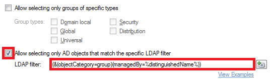

ii. Creating the Home Page Action
  3. Click Add and select the Add to Group action.
  4. On step 2 of the wizard, define the conditions for selecting users to be added to the groups and click Next.
  5. Select Allow selecting only AD objects that match the specific LDAP filter.
  6. Enter the following into the LDAP filter field:
    (&(objectCategory=group)(managedBy=%distinguishedName%))
  7. Click Finish.

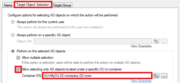

Hello Horst,
I would like to remove the possibility to search
There is no possibility to remove the search bar from the Home Page Action steps. However, you can limit the search with a single container. In your case, we recommend applying the limitation only for the new members selection step. If you limit the groups selection with a specific container, the action will allow selecting groups owned by the initiator only in the container. To apply the limitation:
  3. Double-click the Home Page Action.
  4. Activate the Target Object Selection tab.
  5. Select Allow selecting only AD objects located under a specific OU or container.
  6. In the Container DN field, specify the distinguished name of the required container.
  7. Click OK twice.
to define the columns to display
There is no such possibility. However, you can configure the columns displayed by default. For details, have a look at the following tutorial: https://www.adaxes.com/tutorials_WebInt ... tLists.htm.

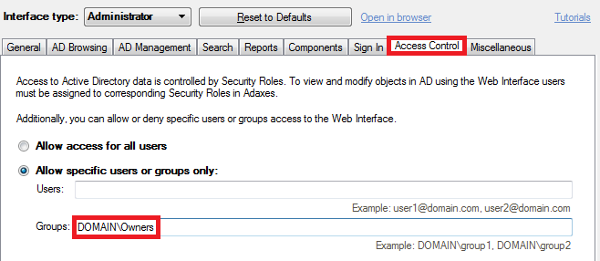

Sure.
The Access Control tab offers the possibility to define AD groups for "Allow sepecific users and groups only:".
And I would like to use the predefined group "Owner (managed by)" for this, but without any clue how do record this.
With quoutes, without quotes, ...
Hello Horst,
Thank you for clarifying. You need to enter the group in the following format: DOMAIN/group. For example:
For more details on how to allow/deny access to Adaxes Web interface, have a look at the following help article: https://www.adaxes.com/help/?HowDoI.Con ... ccess.html.
