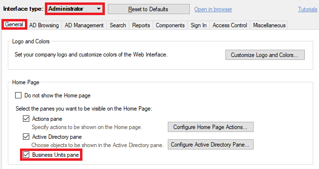

Once you create a Business Unit, you need to enable displaying it in the Web Interface Home Page. To do so:
  2. Select the interface type.
  3. Select Business Units pane on the General tab.

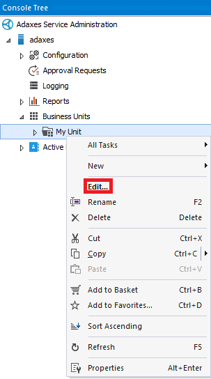

To modify default column settings for an existing Business Unit:
  2. In the Console Tree, expand the service node.
  3. Navigate to Configuration\Business Units.
  4. Right-click the Business Unit you need and click Edit in the context menu.

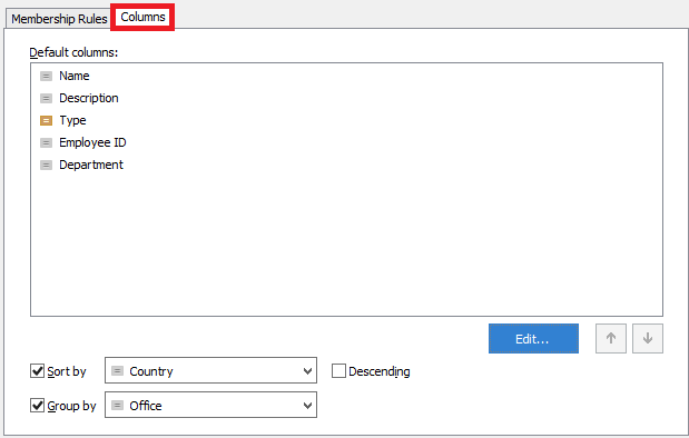

  5. Activate the Columns tab.
  6. Specify which columns will be visible by default for the Business Unit, configure sorting and grouping options.
