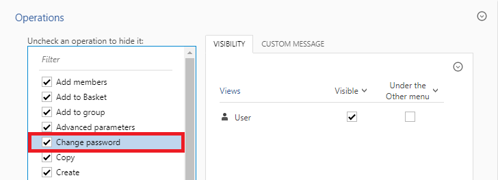

After upgrading to 2018.1 I'm getting an error of "Your password must be changed before you can log in.
The Change Password operation is disabled in the Web Interface." when I try to login for the first time to change my password. I cannot find the setting to enable this.
Has anyone else seen this?
by (300 points)
Hello Jake,
For information on how to configure operations for Web Interfaces in Adaxes 2018.1, have a look at the following help article: https://www.adaxes.com/help/?HowDoI.Con ... tions.html. You need to enable the Change Password operation.
