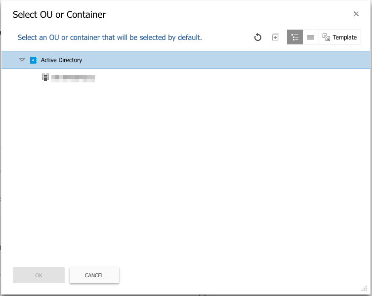

When setting a default OU for new user creation, our domain does not expand. Editing users is fine, installed console is fine. Config was working before upgrade to 2018.1.
Any suggestions?

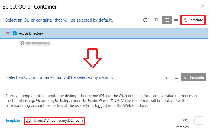

This was a known issue and we have already fixed it. You need download Adaxes 2018.1 from our site again and install it.
If you do not want to re-install Adaxes now, you can specify the distinguished name of the required container/OU using the Template option:

Are you sure you entered the distinguished name (DN) of an existing OU? Could you post here or send us (support[at]adaxes.com) a screenshot of the Select OU or Container step as you have it now?
