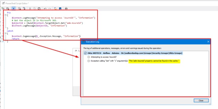

I've tried what you suggested and am so far not being successful. I added a couple of Log statements and captured the error and this is what I am receiving.
I've obfuscated a lot, but I can verify that the group I am trying to get this information on is under the 'associated objects' of my tenant.
Can I please get some additional guidance or thoughts on this situation?
Thank you again.
The behavior is expected as the property is empty for the object you run the script against. It can only be retrieved for users who are licensed for Microsoft 365 or groups that are mail-enabled in Exchange Online. Also, there were some changes introduced by Microsoft and only applied in Adaxes 2023 Update 2 (build number 3.15.23410). If you are using an older version, you need to upgrade to use the script.
