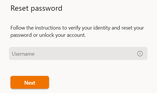

I found a URL that's being used and I am not sure where it's coming from. I've looked everywhere to see how it's even accessible.
The url directs people to a reset password page that's diffferent thn the ones I manage in the web config page. It is not associated with any of the Web Interfaces when I go to edit them.
The URL ends with /adaxes/#/SelfPasswordReset
Image below of the page that looks different than the ones created with web config. This is also not the same as the "Forgot password?" prompt at the bottom of the other Web Interfaces: image.png

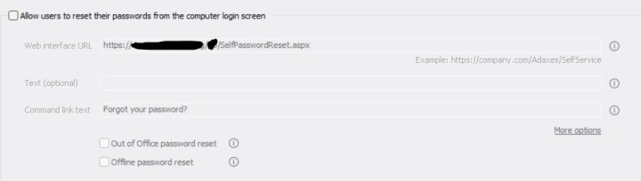

The only spot I've seen it is in OS Integration, but that isn't enabled right now. You can see it's grayed out, and the URL is a bit differen't, the hastag is instead the name of one of the Web Interfaces (I blacked it out in the image below) image.png

The URL is referencing the Password self-service functionality on the Common Sign In page. The base URL of the page is like http://adaxesserver.domain.com/Adaxes. It is set up in the web interface configurator same as other web interfaces. image.png
by (580 points)
