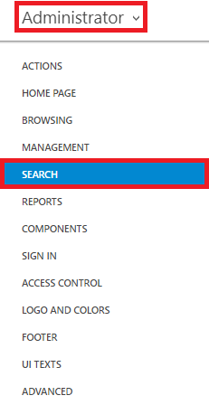

Thank you for the provided details and pointing out the issue. We will investigate the possibilities to improve the search feature in future releases. For now, you can improve the search timing by limiting Quick Search with specific objects (e.g. users and contacts). To do so:
  1. Open Adaxes Web interface Configurator.
  3. In the left pane, click Search.

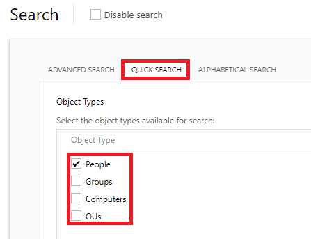

  4. In the Search section, activate the Quick Search tab.
  5. Clear all the checkboxes except for the People one.
  6. Save the changes.
