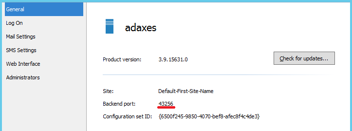

    1. Get the backend port number of your Adaxes service. To do this:
      • In Adaxes Administration Console, right-click your service node.
      • Click Properties in the context menu.
      • The backend port will be displayed below the Check for updates button.

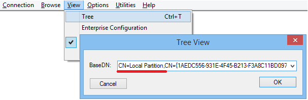

    4. Launch the LDP tool. To do this:
      • Press Win+R.
      • Type ldp.exe.
      • Press Enter.
    5. In the LDP tool window, click Connection and then click Connect.
    6. In the Server field specify the fully qualified domain name of Adaxes server.
    7. In the Port field, specify the service port you noted on step 1 and click OK.
    8. Click Connection and then click Bind.
    9. Specify the username, password and domain of the Adaxes service account (the account used to run Adaxes Service).
    10. Make sure that the Bind with credentials and Encrypt traffic after bind options are enabled and click OK.
    11. In the View menu, select Tree.
    12. In the Base DN drop-down list, select CN=Local Partition,CN={GUID}.
    13. Click OK.

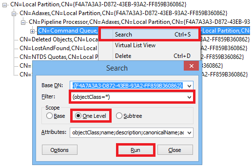

    14. Navigate to CN=Local Partition,CN={GUID} \ CN=Adaxes ... \ CN=Pipeline Processor ... .
    15. Right-click CN=Command Queue ... and click Search.
    16. In the Filter field of the Search dialog, enter (objectClass=*).
    17. Select One level and click Run.
    18. In the Result Pane located to the right, check how many entries were fetched.
