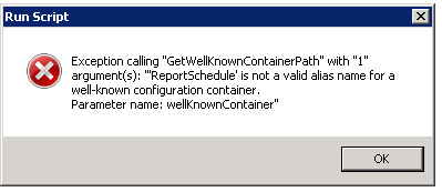

The link is what I want to do but I get the following error.
We are running 2017.2 (3.8.14823.0)
by (2.6k points)
This line is not in my script, which was made for version 2017.
"Reports \ Schedule" = "ReportSchedule", "adm-ReportScheduledTask";
Try to comment out ?
by (2.6k points)
Think you better tighten up registration security/validation in this forum ..... !
by (1.3k points)
Commenting out that line worked. Thank you so much
