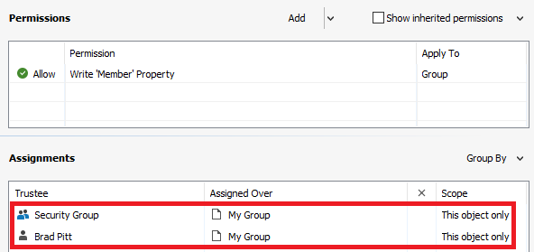

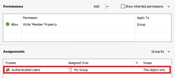

When you use Owner (Managed By) as a trustee for a Security Role, it means that the permissions specified in the role are granted only to the user, specified in the Managed By property of a group. If a user that is not specified in the property tries to update membership of the group, they will get Access Denied, because they do not have corresponding permissions.
If you want to grant all users the permissions to modify group membership, you should use Authenticated users security principal as trustee.
Otherwise, you can specify a security group or certain users.

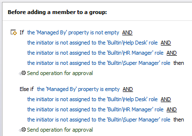

Moreover, I want regular users trigger the approval request but not users having security role of either Helpdesk, HR or of course Super Manager. E.g. a HR representative working In the HR console should not trigger an approval request.
You will need to use a Business Rule triggering Before Adding a member to a group. If a manager (Managed By property) is specified for the group and the initiator is not assigned to either of the Security Roles (Help Desk, HR Manager or Super Manager), the rule will send an approval request to the group manager (first set of actions and conditions). If a manager (Managed By property) is not specified for the group and the initiator is not assigned to either of the Security Roles (Help Desk, HR Manager or Super Manager), the rule will send an approval request to Help Desk (Else If block).
