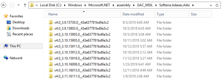

With the code below in a normal Powershell-ISE, I get error message below.
For troubleshooting purposes, navigate to folder C:\Windows\Microsoft.NET\assembly\GAC_MSIL\Softerra.Adaxes.Adsi on the computer where you run the script and post here or send us (support[at]adaxes.com) a screenshot of the folder contents. Please, make sure that full names of folders are included. We need something like the following:
Also, please, check which folders located in the Softerra.Adaxes.Adsi folder contain files and provide us with the folder names (e.g. v4.0_3.9.15631.0__43a637781bd9a3c2).
