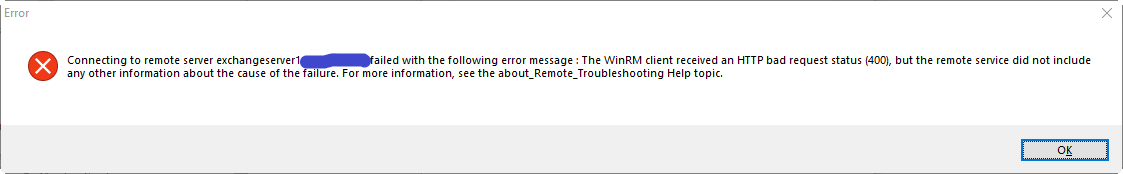

I am attempting to setup a connection to a different forest and am having some issues. We have an Exchange 2013 server environment setup and when I open a user who has a mailbox, it gives the following error
I have followed the information provided here:
Adaxes and Exchange in a multi-forest environment
I configured the powershell virtual directory to use an SSL connection. I verified that it is using the correct certificate for the site in IIS. The authentication is currently set to Integrated Windows Authentication. I can connect remotely via powershell from our Adaxes service server with the following command using the correct Domain Credentials:
New-PSSession -ConfigurationName Microsoft.Exchange -ConnectionUri https://exchangeserver1.domain.com/PowerShell/ -Credential $cred
Any suggestions that you can give would be fantastic. Thank you.

For troubleshooting purposes, please, enable tracing of requests sent to Exchange servers, reproduce the issue and send us (support[at]adaxes.com) the log file or post the content of the file here. For information on how to enable the tracing, have a look at the following help article: https://www.adaxes.com/help/?HowDoI.Per ... uests.html.
Sent Logs to the support email.
