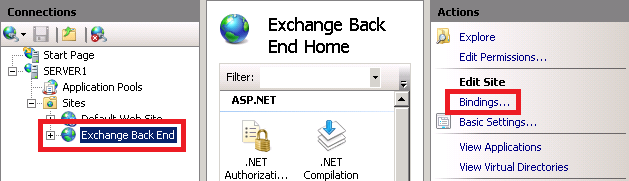

After a closer look into your issue, we've found that it might be a certificate issue. As we discovered in this thread, there is a common issue where Exchange deletes client certificates or binds an incorrect certificate during upgrades. This can result in an issue as you describe. Also, this can account for the difference in behavior when Adaxes and Exchange are in the same forest and when they are in different forests. When Adaxes and Exchange are within the same forest, the HTTP protocol is used, and it doesn't matter whether a certificate is present and valid. When they are in different forests, the HTTPS protocol is used, which requires a valid certificate to establish a connection.
To check this:
  1. On one of the failing Exchange Servers, launch the Internet Information Services (IIS) Manager from Control Panel \ Administrative Tools.
  2. Expand your server node, then expand Sites and select the Exchange Back End site.
  3. In the right view pane, click Bindings.

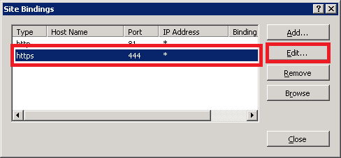

  4. Select the https binding on port 444, and then click Edit.

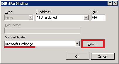

  5. Make sure that the Microsoft Exchange certificate is selected.
  6. Click the View button associated with the SSL certificate field and make sure that the certificate is valid and not expired.
