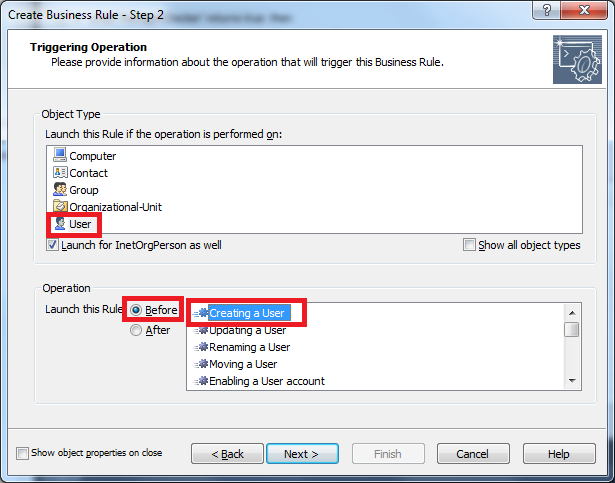

If you prefer using the Employee Type property, we suggest the following solution: you need to create a Business Rule that will trigger before creating a user and check the user's Manager property. If this property is not empty, the Business Rule will then check the manager's employeeType property. If this property equals Contractors, then the Business Rule will cancel the user creation operation. All checking operations will be performed by a PowerShell script.
To create such a Business Rule, follow these steps:
  2. On the 2nd step of the Business Rule creation wizard, select User and Launch this Rule before Creating a User.

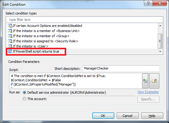

  5. Add the If PowerShell script returns true condition.
  6. Paste the following script:
     # The condition is met if $Context.ConditionIsMet is set to $True.
     $Context.ConditionIsMet = $False;
     if ($Context.IsPropertyModified("manager"))
         $manager = $Context.BindToObjectByDN("%manager%")
             $managerType = $manager.Get("employeeType")
         if ($managerType -eq "Contractor")

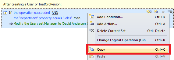

I supose we could also just hide this field and populate the manager from a business rule linked to the users department.

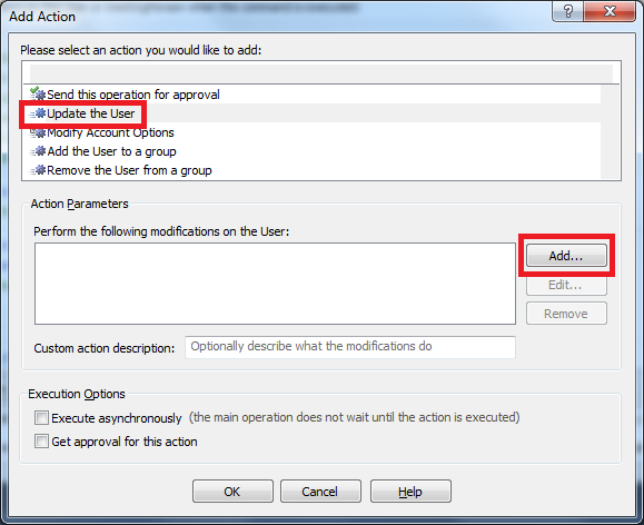

This one is very easy to do:
  2. On the 2nd step of the Business Rule creation wizard, select User and Launch this Rule after Creating a User.
  3. On the 3rd step of the wizard, add the Update User action and click Add.

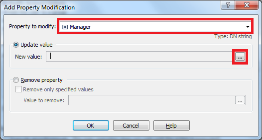

  4. In the dialog box that appears, select Manager in the Property to modify field.
  5. Click the Edit button in the New value field.
  6. Select the user whom you want to be the manager for the first department and click OK 3 times.

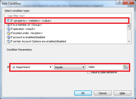

  7. Click Add Condition.
  8. Select the If <property> <relation> <value> condition and select If Department equals [Department name], where [Department name] is the name of the department, for which you are setting this particular manager.
  9. Click OK and finish creation of the Business Rule.
  10. Repeat these steps for as many departments as you have. Actually, you may even copy and paste the whole set of actions and conditions and then just change the department names and the managers.
