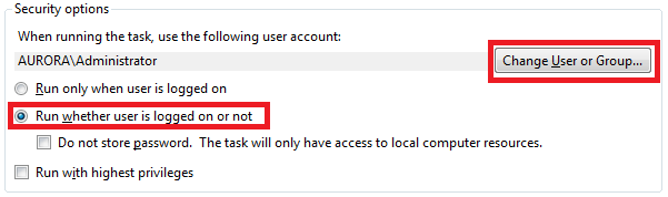

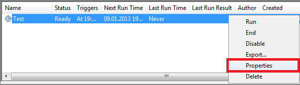

Yes, this is possible. You can set the Task to execute Softerra.Adaxes.BackupRestore.exe under the credentials of Adaxes default service administrator. In this case you can launch Adaxes Backup/Restore tool without passing the credentials of Adaxes default service administrator via the command line. To do this:
  1. Locate your Task in the Task Scheduler library, right-click it and select Properties.
  2. In the dialog box that appears, activate the General tab.
  3. Press the Change User or Group button in the Security options section.
  4. In the dialog that appears, select the Adaxes default service administrator.
  5. Switch the radio button to Run whether user is logged on or not.
  6. Press OK.
  7. You will be prompted for a password to the account that you specified in the 3rd step. Type the password and press OK.

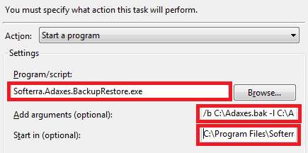

Actually, you may fully retire the batch file and specify all the necessary options for Adaxes Backup/Resotre tool in the parameters of the Windows Task Scheduler Task:
  2. In the dialog box that appears, activate the Actions tab.
  3. Double-click the Start a program action that launches your batch file.
  4. Type Softerra.Adaxes.BackupRestore.exe in the Program/script field.
  5. Type the command line parameters for the Adaxes Backup/Restore tool in the Add arguments (optional) field, for example /b C:\Adaxes.bak -l C:\AdaxesBackup.log
  6. Type the full path to the folder, in which your Adaxes service is installed, in the Start (optional) field, for example, C:\Program Files\Softerra\Adaxes 3\Service.
  7. Click OK two times.
