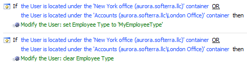

We suggest the following workaround. You can create a Scheduled Task that will set a certain property of the objects located under the necessary containers to a value that you specify.
Here's an example of such a Scheduled Task that sets the Employee Type property to MyEmployeeType:

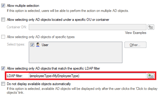

Then, when configuring the Target Object for a Home Page Action, you can use the property value that you specified in the LDAP filter field:
That should do the job.
