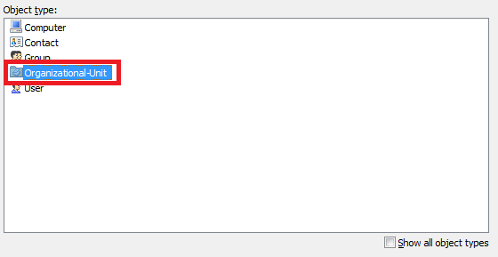

To create a Custom Command that can be executed on an Organizational Unit to count the number of users in that Organizational Unit:
  2. On the 2nd step of the Create Custom Command wizard, select the Organizational-Unit object type.

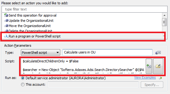

  3. On the 3rd step, add the Run a program or PowerShell script action and paste the following script:
     $calculateDirectChildrenOnly = $False # When set to $True, calculates only the users who are direct children of the target OU
     $searcher = New-Object "Softerra.Adaxes.Adsi.Search.DirectorySearcher" @($NULL, $False)
     $searcher.SearchParameters.BaseObjectPath = $Context.TargetObject.ObjectInfo.Path
     [String[]]$objectTypes = "user"
     $searcher.SearchParameters.Filter = [Softerra.Adaxes.Ldap.FilterBuilder]::CreateObjectTypesFilter($objectTypes)
     $searcher.SearchParameters.PageSize = 100
     $searcher.SearchParameters.PropertiesToLoad.Add("1.1")
     if ($calculateDirectChildrenOnly)
         $searcher.SearchParameters.SearchScope = "ADS_SCOPE_ONELEVEL"
     $iterator = $searcher.ExecuteSearch()
         $result = $iterator.FetchAll().Count
         $iterator.Dispose()
     if ($result -eq 0)
         $Context.LogMessage("The OU doesn't contain any users", "Information")
         $Context.LogMessage("The OU contains $result user(s)", "Information")
    In the script, $calculateDirectChildrenOnly controls whether the script counts only users who are direct children of the OU or all users at any nesting level. Set this variable to $True if you want the script to count only users who are direct children of the OU.

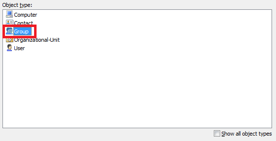

To create a Custom Command that can be executed on a Group to count the number of users in that Group:
  2. On the 2nd step of the Create Custom Command wizard, select the Group object type.
