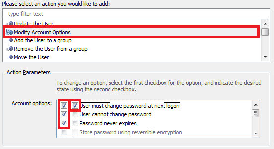

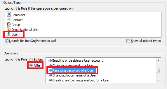

Yes, you need to create a Business Rule that will be executed after resetting a password for a user and that will set the necessary values in the Account Options property with the help of the Modify Account Options action. To create such a Business Rule:
  2. On the 2nd step of the Create Business Rule wizard, select User and After Resetting password for a User.
  3. On the 3rd step, add the Modify Account Options action.
  4. Check the first checkboxes against the User must change password at next logon, User cannot change password and Password never expires options.
  5. Check the second checkbox against the User must change password at next logon option.
  6. Click OK two times and finish creation of the Business Rule.

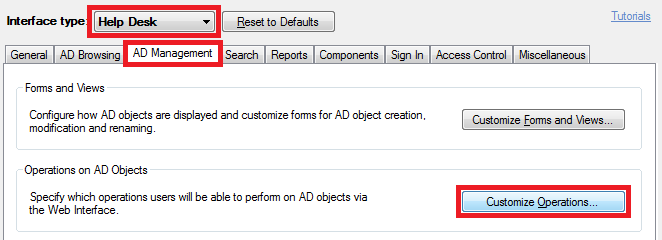

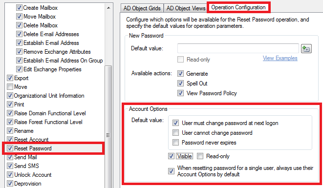

Yes, the feature was implemented in Adaxes 2013.1. To configure Account Options for the Reset Password operation:
  1. On the computer where your Web Interface is installed, start the Web Interface Customization tool.
  3. Activate the AD Management tab and click Customize Operations.
  4. Select Reset Password in the Operations list.
  5. Activate the Operation Configuration tab.
  6. In the Account Options section, you can configure the default Account options that will be applied when resetting a password for a user.
