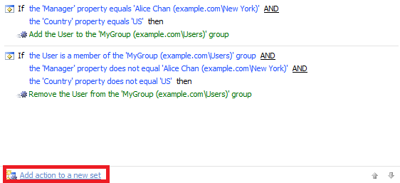

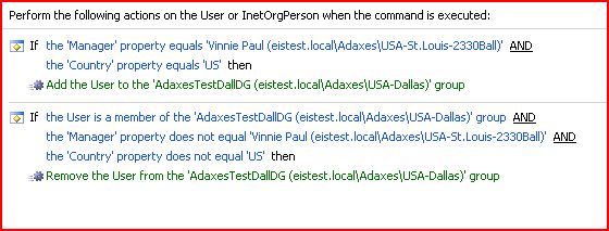

As to the solution requested, the easiest way to achieve your task would be to add a set of actions and conditions that would add the manager to the group. In the case that you provided as an example in your screenshot, you can check, for example, if the username equals to Vinnie Paul's username and add the user to the group, if it equals. To do this:

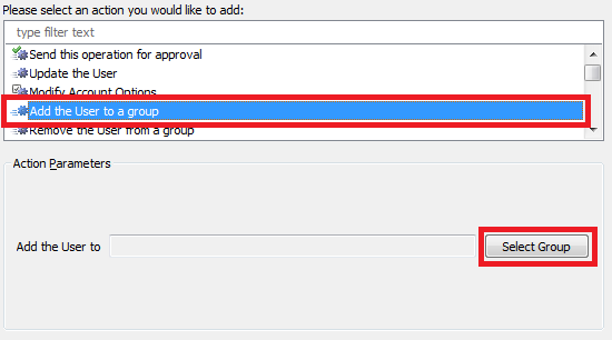

  4. Select the Add the user to a group action and click Select Group.
  5. In the dialog box that appears select the group you need (e.g. AdaxesTestDallDG) and click OK two times.

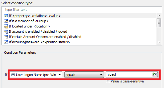

  7. Select the If condition.
  8. Select User Logon Name (pre-Windows 2000) equals and type Vinnie Paul's SAMAccountName.
  9. Click OK and save the Custom Command

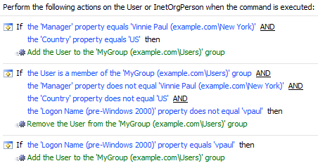

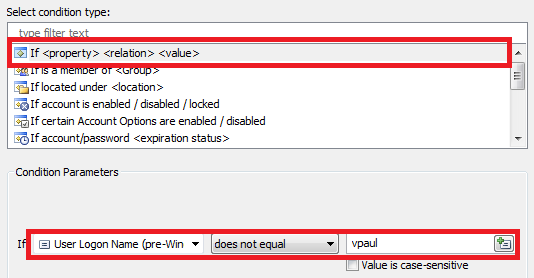

Also, you will need to add a condition to the second set of actions and conditions that checks if the username does not equal to Vinnie Paul's username. This condition is required not to remove Vinnie Paul from the group. To add such a condition:
  1. Select the second set of actions and conditions.
  2. Click the Add Condition button.
  3. In the dialog box that appears, select the If condition.
  4. Select User Logon Name (pre-Windows 2000) does not equal and type Vinnie Paul's SAMAccountName.
  5. Click OK and save the Custom Command.
You should end up with a Custom Command that is similar to this one:
