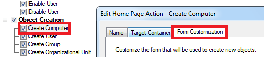

The thing is that you cannot create a computer without the Computer Name (cn) property specified. Also, you cannot set the Computer Name property with a script, you should set the Name property instead. What we suggest is that you add a predefined field to your Home Page Action that will set the Computer Name for every newly created computer to a certain random value. Then, with the help of your Business Rule, you will set the Computer Name to the value that you need. To do this:

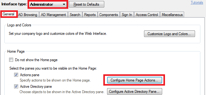

  1. Launch the Web Interface Configuration tool.
  2. In the Interface type drop-down list, select the Web Interface, for which you've configured the Home Page Action that creates computers.
  3. Click Configure Home Page Actions.
  4. Double-click the Home Page Action that you will use to create new computers.
  5. Switch to the Form Customization tab.

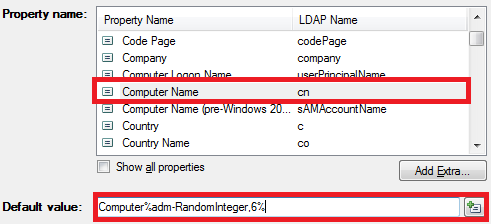

  6. In the Predefined Fields section, click Add.
  7. Select the Computer Name property in the Property name list.
  8. Specify a template for random computer name generation in the Default value field, for example, Computer%adm-RandomInteger,6%. %adm-RandomInteger% is a value reference that will be replaced with a random integer. For more information on value references, see Value Reference Format. Also, remember, that a computer name cannot consist of numbers only.
  9. Click OK 4 times.
