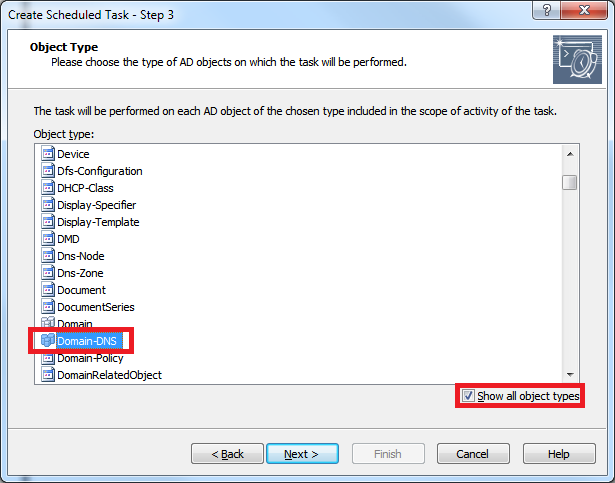

STEP 1: Scheduled Task to update User Pattern
  2. Launch the Create Scheduled Task wizard.
  3. On the 3rd step of the wizard, select the Show all object types checkbox and select the Domain-DNS object type.
  4. On the 4th step, click Add Action, select Run a program of PowerShell script, and paste the following script:
