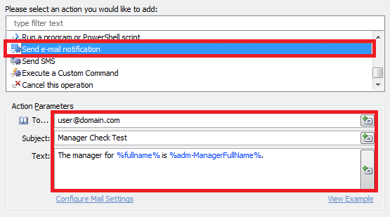

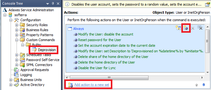

First of all, to access a user's manager and send an email containing the user's manager full name, you do not need any scripting. Adaxes has value references for calculated (virtual) properties that you can use to access information on the manager in the text of the message for the Send email notification action. For more information, see Calculated Properties. So, for example, if you need to send an email notification containing the manager's full name, you need to add the Send email notification action to your Business Rule, Custom Command or Scheduled Task and use the %adm-ManagerFullName% value reference in the message text. To add such an action:
  2. In the Console Tree, locate and select the Business Rule, Custom Command or Scheduled Task that you want to add the action to.
  3. Select the necessary set of actions and conditions and click Add Action.
    ***- or -*
    Click the
    Add action to a new set** link.
  4. Select the Send email notification action.
  5. Set up the template for email notification.

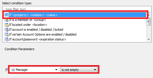

  6. If necessary, you can use the If <property> <relation> <value> condition to check whether the user has a manager.

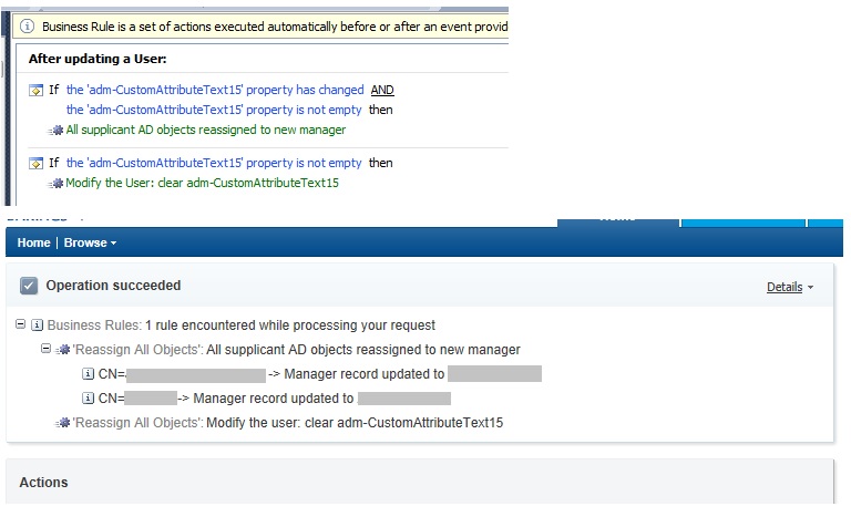

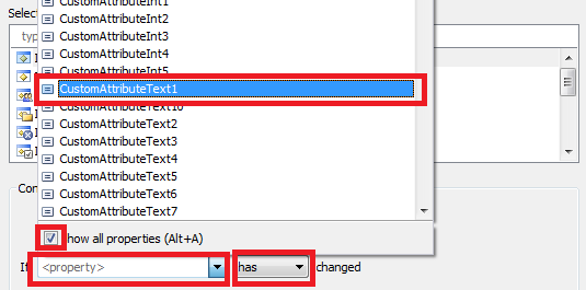

To implement the solution that we suggested above, you need to create a Home Page Action that will modify a user and will contain only one property on the form. The property will be used to input the name of the user that will become the 'replacement manager'. For example, you can use CustomAttributeText1. The user will need to be specified by the username.
Then, you can create a Business Rule that will be triggered after updating a user and will check whether the value of the property that you chose to pass the username has changed. If the property has changed, the Business Rule will use a PowerShell script to set the specified user as the owner / manager of the objects and, optionally, perform other actions related to deprovisioning.

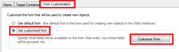

I. Create a Home Page Action with a customized input form

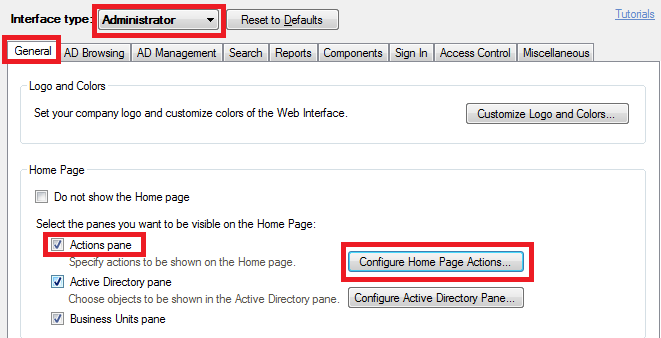

  1. On the computer, where your Web Interface is installed, start the Web Interface Customization tool.
  3. Activate the General tab, select the Actions pane option, and click Configure Home Page Actions.
  4. In the dialog box that appears, click Add.
  5. On the 1st step of the Add Home Page Action wizard that appears, select Modify and choose User from the associated drop-down list.
  6. On the 4th step of the wizard, select Use customized form and click Customize Form.

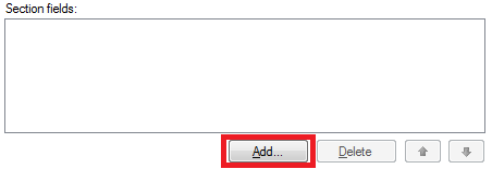

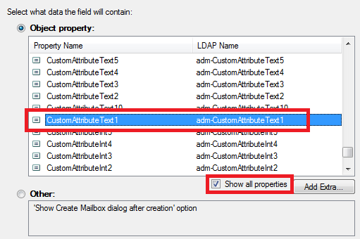

  7. In the Customize Form dialog that appears, you need to remove all the fields in the General section. On how to delete fields, refer to step 6 of the Customize Forms for User Creation and Editing Tutorial.
  8. Now, you need to add the virtual property that you will use on your form. To add a property to a web Interface form, click the Add button below the Section fields section.
  9. In the dialog box that appears, you need to select the virtual property that you will use. As virtual properties are not displayed by default, you need to tick Show all properties to be able to select them.
  10. Select the virtual property that you will use, for example CustomAttributeText1.
  11. Click OK.
  12. Finish the Add Home Page Action wizard.

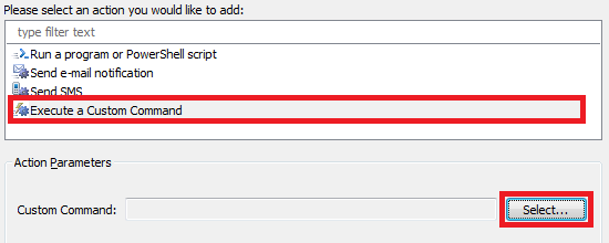

II. Create a Business Rule that to automatically reassign object ownership / management

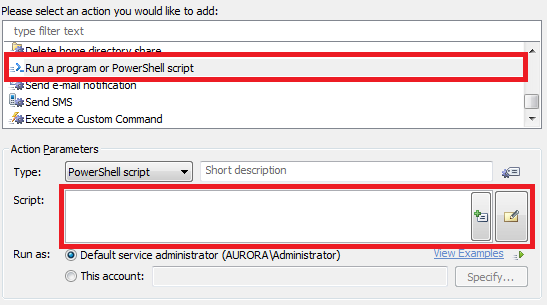

  3. On the 3rd step, add the Run a program or PowerShell script action and paste the following script.

             $managedObject = $Context.BindToObjectByDN($managedObjectDN)
             $managedObject.Put("managedBy", $manager.distinguishedName)
             $managedObject.SetInfo()
     # Get subordinates
         $subordinateDNs = $Context.TargetObject.GetEx("directReports")
         $subordinateDNs = $NULL
     if ($subordinateDNs -ne $NULL)
         foreach ($subordinateDN in $subordinateDNs)
             $subordinate = $Context.BindToObjectByDN($subordinateDN)
             $subordinate.Put("manager", $manager.distinguishedName)
             $subordinate.SetInfo()
  4. Add a short description for the script and click OK.
  5. Optionally, you can set the Business Rule to perform the rest of the deprovisioning process. For example, it can perform a Custom Command used for user deprovisioning. To do this, click the Add Action button.
  6. In the dialog box that appears, select the Execute a Custom Command action and click Select.
  7. Select the Custom Command that you use for use deprovisioning and click OK two times.
  8. Now you have to add a condition when the actions will be triggered. The name of the 'replacement manager' will be passed in the CustomAttributeText1 property, so we need to check in the Business Rule whether CustomAttributeText1 has changed. To do this, click the Add Condition button.
  9. In the dialog box that appears, select the If <property> <changed> condition.
  10. In the <property> drop-down list, select Show all properties.
  11. Select the property that you chose to pass the username.
  12. Select has changed.
  13. Click OK and finish creation of the Business Rule.
To address this, in our scenario, we are already considering a dedicated 'Deprovisioning Errors' OU so that any users that cannot be fully deleted are instead moved to this holding OU <CUT> One advantage of this is that we could maybe delete one of the existing 'name capable' attributes (deputy, assistant) as part of moving into this OU, and then use that to temporarily define the replacement manager value (with appropriate explanation on the custom form as to why the field name is wrong!).
If you decide on using this scenario, this will be simple to achieve. The thing is that Adaxes allows you to create custom hints and help for properties using Property Patterns. For information on how to achieve such a task, see Provide Custom Help and Tips for AD Object Properties.
So, you can create a separate Property Pattern with the custom hint and/or help for the Assistant or the Secretary property and include only the necessary OU in the Activity Scope of the Property Pattern.
In this case, you will need a slightly modified script to set the replacement manager.

FYI All working as expected - created Home Page Action so admin's can 'Reassign' objects, they choose the AD object for the 'old' manager, enter the Username of the 'new manager' (currently freeform text field for testing), which triggers the business rule.
I had to tweak the rule to stop a loop condition being created, but I think that's just inexperience on my part - see below screenshot #1 - and I also added some custom text to the logged messages so that the web portal user gets positive feedback for the performed actions - screenshot #2.
I am temporarily using CustomText15 for testing etc, but will be integrating this logic into the operational procedures when I hope to switch to one of the built-in AD fields that support user object selection (manager\assistant) so that it must be performed against a valid, current, user object.
