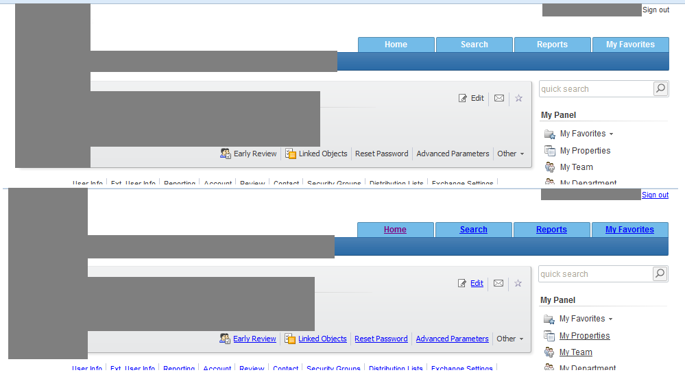

Hi - we've started testing adding the Exchange component to users' portal and get this strange effect that started at the same time:-
Top picture is the page as it first loads
Bottom picture is the page as soon as the Exchange section loads - all the links suddenly go crazy.

As to Web Interface corruption, the most probable reason is that you have either an HTML-formatted MailTip or an Out-of-Office (OOF) Reply message specified for the users that you are experiencing issues with, and that HTML message is corrupted. For example, it doesn't have all the tags closed or something like that. When Adaxes loads such an improperly formatted HTML message, it corrupts the whole of the page displayed by the Web Interface.
To check this, you can, for example, try disabling MailTip for one of the users and see if it helps.

You are in the right ballpark with the UI corruption - if I turn off any OOO messages the issues vanish. When I turn them on - even if the message boxes are blank we have the issues.
The thing is that Exchange does not allow to save the properties of an Exchange recipient if the OOF feature is enabled, but the message text is empty. So, we think that there is some text. Most probably, it is an unclosed tag that is not visible in the message editor (since it does not have text in it), but corrupting the Web Interface page.

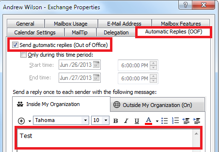

To resolve the issue, we can suggest the following:

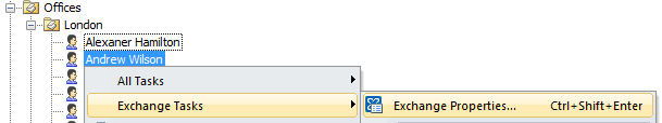

  2. In the Console Tree, navigate to and select one of the users that is causing the issue.
  3. Right-click the user, select Exchange Tasks, and then Exchange Properties in the context menu.
  4. Activate the Automatic Replies (OOF) tab.
  5. Select the Send automatic replies (OOF) option.
  6. Activate the Inside My Organization tab.
  7. Place the cursor in the message editing field.
  8. Press Ctrl+A to select the whole text, and then press Delete.
  9. Type some message in the message editing field.
  10. Click OK.
  11. Check whether the issue reappears for this specific user.
