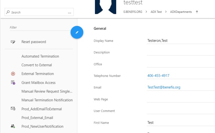

image.png To the left of the user object there are several custom commands showing. I don't want our service desk to see them. Why are they showing? How do I remove them. Must be something simple. They only see these when looking at a user Object.
by (1.2k points)
by (16.6k points)
You can hide the custom commands by disabling the corresponding operations in the Web interface. For details, have a look at the following tutorial: https://www.adaxes.com/help/DisallowCertainOperationsOnObjects.
