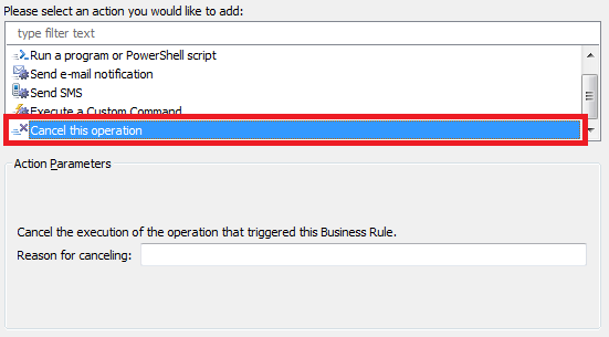

    • On the 3rd step, add the Cancel this operation action. This will allow canceling creation of the objects of the selected type when certain conditions are met.

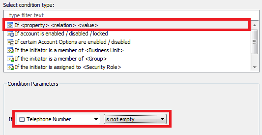

    • In the dialog box that appears, select the If <property> <relation> <value> condition type.
    • In the <property> drop-down list, select the property that you would not like users to be able to set.
    • Select is not empty and click OK.

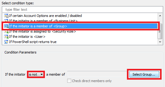

    • Also, you can add additional conditions to prevent modification of the properties only in certain cases. For example, if you would like only members of the Help Desk group to be able to specify telephone numbers for users, you can add a condition to cancel the operation only when the operation initiator is not a member of the Help Desk group. For this purpose, click the Add Condition button.
    • Select the If initiator is a member of <Group> condition.
    • Select the is not condition operator.
    • Click Select Group and select the Help Desk group.

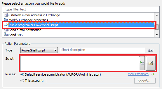

To implement such a solution, you need to create a Business Rule executed after creating an object. The Business Rule will launch a PowerShell script to find and clear all the properties that the user cannot modify. To create such a Business Rule:
  2. On the 2nd step of the Create Business Rule wizard, select the object type, creation of which you would like to check, and then select a Business Rule type that is triggered after creating objects of the selected type. For example, if you want to check, which properties are set for new users, select User and After Creating a User.
  3. On the 3rd step, add the Run a program or PowerShell script action and paste the following script in the Script field.
