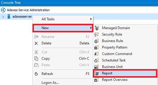

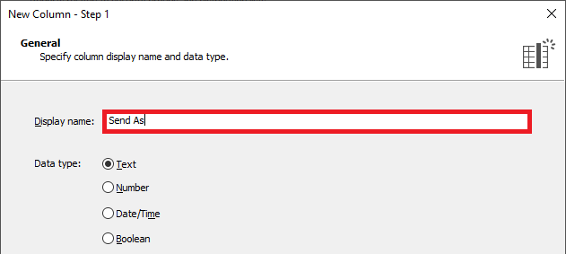

Thank you for the confirmation. To create the report:

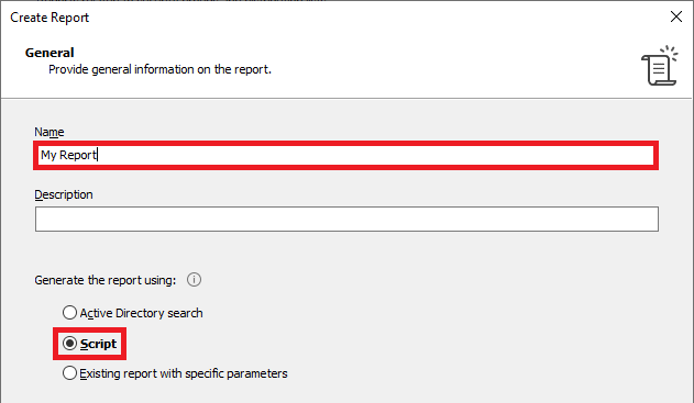

  4. Specify a report name.
  6. Click New.
  7. Click Next twice and then click Finish.
  8. Click Next twice.

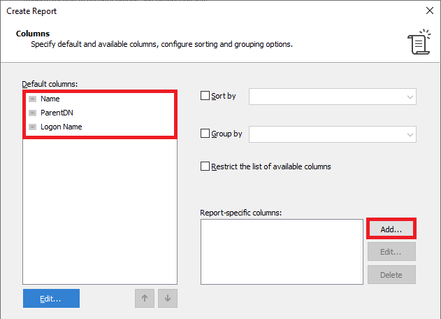

  9. Add the ParentDN and Logon Name columns to the Default columns list.
  11. Specify the display name for the custom column that will contain usernames of accounts that have Send As permissions on the mailbox. image.png

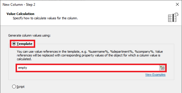

  13. Select Template.
  14. In the field below, specify a default column value (e.g. empty). The value is only required to create the custom column and will never be present in the report. image.png
  15. Click Finish.

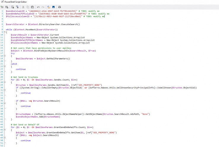

  18. Paste the below script into the corresponding field. In the script:
    • $sendAsColumnID - Specifies the identifier of the custom column that will contain usernames of accounts that have Send As permissions on the mailbox. To get the identifier of a custom column:

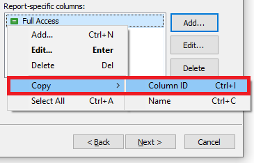

      1. On the Columns step, in the Report-specific columns section, right-click the column you need.
      2. In the context menu, navigate to Copy and then click Column ID. image.png
      3. The identifier will be copied to the clipboard.
    • $sendOnBehalfOfColumnID - Specifies the identifier of the custom column that will contain usernames of accounts that have Send on Behalf permissions on the mailbox.
    • $fullAccessColumnID - Specifies the identifier of the custom column that will contain usernames of accounts that have Full Access permissions on the mailbox.
$sendAsColumnID = "{dd288413-e52e-496f-b419-fb77012d2259}" # TODO: modify me
$sendOnBehalfOfColumnID = "{b8393021-85d0-45e0-bde4-6ec2fe4d8f79}" # TODO: modify me
$fullAccessColumnID = "{3176bc12-9853-4add-982f-212728ecd0e6}" # TODO: modify me

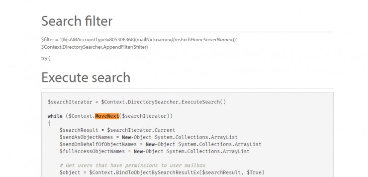

do i have to copy the complete code in the script box?
do i have to copy the search filter into the script?
thank you
Sorry for the confusion, there were some issues with displaying the script. We fixed the issue. Please, copy the script from the instructions above.
by (200 points)
perfect! now it works as expected! thank you for the great work and help!

The thing is that not all mailboxes have the permissions part. Also, in specific exchange versions specific rights are also absent. The easiest way to work around the issue would be to predefine the types of mailboxes that will be included into the report. Alternatively, we can update the script so that it does not include mailboxes for which retrieving either permissions fails into the report.
by (200 points)
the report stops at the first null-valued-expression
how can i predefine the included mailboxes?
would it be easier to to handle such mailboxes in the script? i think an update would be better for the script!
would you be so kind and do that for me? thank you very much
Thank you for specifying. We updated the script accordingly. Find it below. In the script, we added the $recipientTypeDetails variable that specifies types of mailboxes that should be included into the report. The variable should be set to an array of corresponding Recipient Type Details property values. For example, 1 references a User mailbox. For details about the property values, have a look at the following post on Microsoft forums: https://answers.microsoft.com/en-us/msoffice/forum/msoffice_o365admin-mso_exchon-mso_o365b/recipient-type-values/7c2620e5-9870-48ba-b5c2-7772c739c651.
$recipientTypeDetails = @(1, 4) # TODO: modify me
# Search filter
$filter = "(&(sAMAccountType=805306368)(|"
foreach ($type in $recipientTypeDetails)
    $filter += "(msExchRecipientTypeDetails=$type)"
$filter += "))"
$Context.DirectorySearcher.AppendFilter($filter)
    # Execute search
        $sendAsObjectNames = New-Object System.Collections.ArrayList
        $sendOnBehalfOfObjectNames = New-Object System.Collections.ArrayList
        $fullAccessObjectNames = New-Object System.Collections.ArrayList
        # Get users that have permissions to user mailbox
        $object = $Context.BindToObjectBySearchResultEx($searchResult, $True)
            $mailboxParams = $object.GetMailParameters()
        # Get Send As trustees
        for ($i = 0; $i -lt $mailboxParams.SendAs.Count; $i++)
            $trustee = $mailboxParams.SendAs.GetItem($i, [ref]"ADS_PROPERTY_NONE")
            if ([System.String]::IsNullOrEmpty($trustee.ObjectSid) -or [Softerra.Adaxes.Utils.WellKnownSecurityPrincipalInfo]::IsWellKnown($trustee.ObjectSid))
            if ($NULL -eq $trustee.SearchResult)
            $trusteeName = [Softerra.Adaxes.Utils.ObjectNameHelper]::GetObjectName($trustee.SearchResult.AdsPath, "None")
            $sendAsObjectNames.Add($trusteeName)
        # Get Send on Behalf Of
        for ($i = 0; $i -lt $mailboxParams.GrantSendOnBehalfTo.Count; $i++)
            $object = $mailboxParams.GrantSendOnBehalfTo.GetItem($i, [ref]"ADS_PROPERTY_NONE")
            if ($NULL -eq $object.SearchResult)
            $objectName = [Softerra.Adaxes.Utils.ObjectNameHelper]::GetObjectName($object.SearchResult.AdsPath, "None")
            $sendOnBehalfOfObjectNames.Add($objectName)
        # Get Full Access trustees
        if ($NULL -ne $mailboxParams.MailboxRights)
            $mailboxPermissions = $mailboxParams.MailboxRights.GetPermissions()
            foreach ($mailboxPermission in $mailboxPermissions)
                if (!($mailboxPermission.AllowedRights -band [Softerra.Adaxes.Interop.Adsi.Exchange.ADM_EXCHANGE_MAILBOX_RIGHTS_ENUM]::ADM_EXCHANGE_MAILBOX_RIGHTS_FULL_ACCESS) -or
                    $mailboxPermission.InheritedAllowedRights -band [Softerra.Adaxes.Interop.Adsi.Exchange.ADM_EXCHANGE_MAILBOX_RIGHTS_ENUM]::ADM_EXCHANGE_MAILBOX_RIGHTS_FULL_ACCESS)
                $trustee = $mailboxPermission.Trustee
                if (!([System.String]::IsNullOrEmpty($trustee.ObjectSid)) -and
                $fullAccessObjectNames.Add($trusteeName)
        $customColumns = @{
            $sendAsColumnID = [System.String]::Join(", ", $sendAsObjectNames.ToArray());
            $sendOnBehalfOfColumnID = [System.String]::Join(", ", $sendOnBehalfOfObjectNames.ToArray());
            $fullAccessColumnID = [System.String]::Join(", ", $fullAccessObjectNames.ToArray());
        $Context.Items.Add($searchResult, $customColumns, $NULL)
