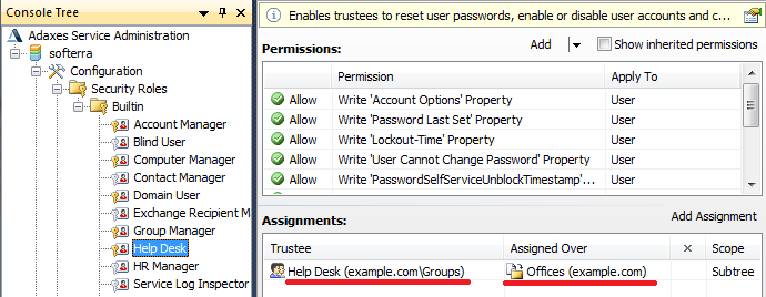

First of all, you need to check the Assignments of your Security Role. The Assignments of a Role define the Trustees, i.e. users who will be able able to apply the permissions granted by the Role. The Assignment Scope defines where the Trustees will be able to apply the permissions of the Role. You need to check whether the Role is assigned to your helpdesk users and whether the Assignment Scope of the Role includes the users they can modify.
For example, on the screenshot below, the Help Desk Role is assigned to the Help Desk group, and the members of the group are able to apply the permissions granted by the role within the OU called example.com\Offices.
To view Assignments of a Security Role, you need to select it in the Console Tree of Adaxes Administration Console. The Assignments will be displayed in the Result Pane (located to the right).

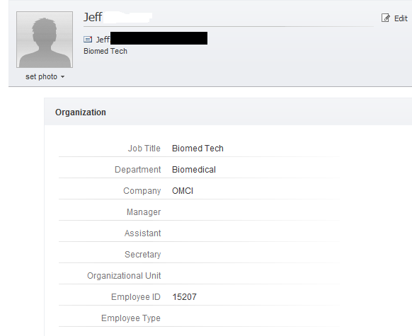

Thank you for the prompt reply. I feel I have a good grasp on the permissions, assignment scopes etc. 90% of what we're trying to accomplish is working with the exception of their (Helpdesk) ability to update organization information. Specifically Job Title, Department, and Company properties in AD.
In the first screenshot you can see how they have the abiltiy to view/read this information.

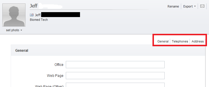

However when they click edit, they only have the ability to alter General, Telephones, Address categories.
What changes do I need to make so that they have the ability to alter these Job Title, Department, Company properties as well?
The reason why the properties do not appear is not in permissions. It is in the configuration of Adaxes Web interface. To give users the ability to modify the properties via the Web interface, you need to add the Organization section with the necessary properties to the form used for modifying users. See the following tutorial for instructions on how to do this: http://www.adaxes.com/tutorials_WebInte ... diting.htm
