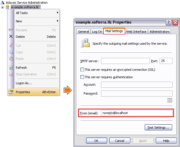

reply to address - is there a way to customize the from address and have it go to HR for this particular process in the event the manager want to reply via email?
currently we left the default at noreply@localhost.
Yes, it is possible:
  • Right-click your Adaxes service and click Properties in the context menu.
  • Click the Mail Settings tab and change the email address in the From (email) field.
ok!
I totally didn't read that the correct way when I initially looked.
Thank YOU
