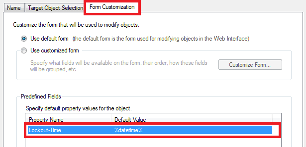

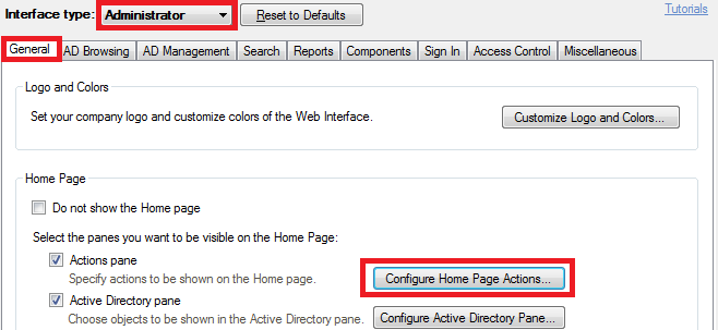

Also, if you are using a Home Page Action, the value can be set as a predefined field of the Home Page Action. To check this:
  1. Launch the Web interface Customization tool.
  2. in the Interface type drop-down list, select the Web interface type that was used when the error occurred.
  4. Double-click the Home Page Action that was used to edit the user.
  5. Switch to the Form Customization tab.
  6. In the Predefined Fields section, search for the Lockout-Time property.
