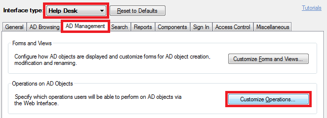

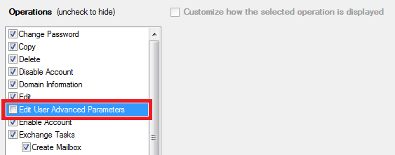

We are going to fix the issue in one of the nearest releases. For now, you can disable the Edit User Advanced Parameters operation for the Web interface in order to avoid the error. To do this:
  1. On the computer, where your Web Interface is installed, start the Web Interface Customization tool.
  3. Activate the AD Management tab and click Customize Operations.
  4. Uncheck the Edit User Advanced Parameters operation in the Operations list.
  5. Click OK.
