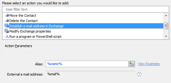

By the way, why don't you use built-in Business Rule actions for this purpose? A Business Rule action called Establish e-mail address in Exchange can do exactly the same as the script that you are trying to test:

You're right, the feature you talk about is exactly what I want but, I think it's only available in the lastest version of Adaxes if I'm right? We are using the version 2012.1 and this feature isn't there (I think so). Since i'm working for a very small business, I dont really need all the other bug fixes and new features right now. I would appreciate if we weren't obligated to buy the upgrade license for this little feature that seems to be accessible via powershell script. Thank you very much for your help it's very appreciated.
That explains everything :)
The Establish e-mail address in Exchange action appeared only in Adaxes 2013.1 that was dedicated to extended support of Exchange features. Adaxes 2012.1 didn't have such a Business Rule action.
