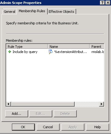

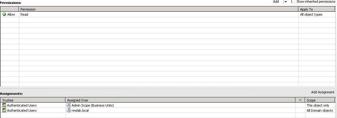

This is the Domain User Role and the Membership Rule.
The rule just has %extensionattribute5% in it and the admin users has and LDAP filter in this attribute to define the users they can control - i.e. (|(depertment=HR)(department=IT))
Setup like this it works, but the Admin can search for any user in the domain which is not what I want. If I remove the domain assignment from the Role then the admin can only find themselves.
The assignment of the Security Role is incorrect for the task you want to achieve. You included the Business Unit in the Assignments of the Security Role, and selected This object only as the assignment scope.
This means that you allowed authenticated users to view the Business Unit itself, but not the members of the Business unit. To allow users to also view members of the Business Unit:
  1. Double-click the assignment of the Role that includes the Business Unit.
  2. Select the Members of this Business Unit option.
  3. Click OK.
  4. Save the Security Role.
