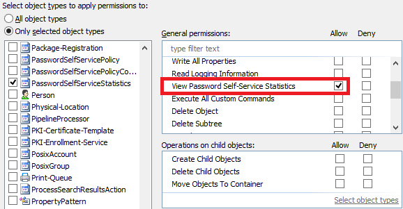

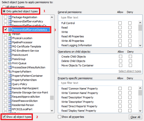

The thing is that Password Self-Service Statistics is represented by a directory object of type PasswordSelfServiceStatistics. The object is stored on Adaxes service backend server (an instance of AD LDS). There is a special permission that can be applied to the object in order to access the statistics. The permission is called View Password Self-Service Statistics.

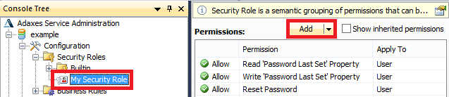

  1. Launch the Adaxes Administration Console.
  2. In the Console Tree, expand the service node you need.
  3. Expand Configuration / Security Roles.
  4. Select the Security Role, to which you want to add the permission to view statistics.
  5. In the Result Pane, click Add above the list of permissions. The Add Permissions dialog will open.
  6. Click Only selected object types and check Show all objects types below the list of object types.
  7. Check the PasswordSelfServiceStatistics object type.
  8. In the 'General permissions' list, select the Allow check box for the View Password Self-Service Statistics permission.
  9. Click OK.
