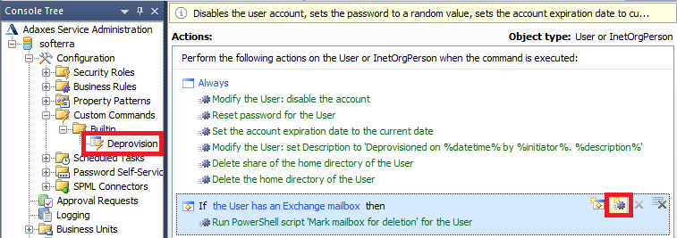

To add an action that will save the mailbox GUID and mailbox store DN in virtual attributes to your Custom Command that you use for deprovisioning:
  2. In the Console Tree, expand the service node that represents your Adaxes service.
  3. Navigate to and select the Custom Command that you use to deprovision users.
  4. Select the set of actions and conditions, in which the user's mailbox gets disconnected.
  5. Click the Add Action button.

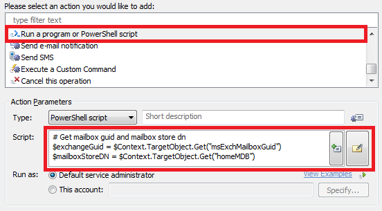

  6. Select the Run a program or PowerShell script action and paste the following script:
     $mbGUIDProperty = "adm-CustomAttributeBinary1" # TODO: modify me
     $mbStorePathProperty = "adm-CustomAttributeText1" # TODO: modify me
     # Get mailbox guid and mailbox store dn
     $exchangeGuid = $Context.TargetObject.Get("msExchMailboxGuid")
     $mailboxStoreDN = $Context.TargetObject.Get("homeMDB")
     # Save exchange guid and database dn in custom attribute
     $Context.TargetObject.Put($mbGUIDProperty, $exchangeGuid)
     $Context.TargetObject.Put($mbStorePathProperty, $mailboxStoreDN)
  7. In the script:
    • $mbGUIDProperty - specifies the virtual attribute that will be used to store the mailbox GUID,
    • $mbStorePathProperty - specifies the virtual attribute that will be used to store the mailbox store DN.
    Modify them, if necessary.
  8. When done, click OK.

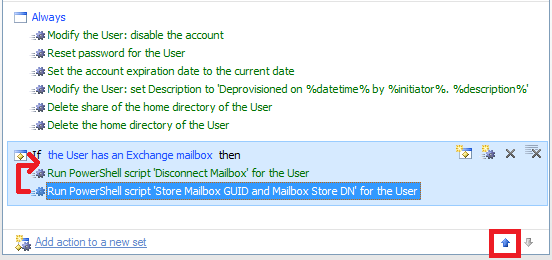

  9. Now you need to put the action before the mailbox is disconnected, otherwise the necessary properties will be deleted by Exchange before Adaxes can save them. For this purpose use the Move Up button located at the bottom of the list of actions and conditions.
  10. When done, click Save changes.

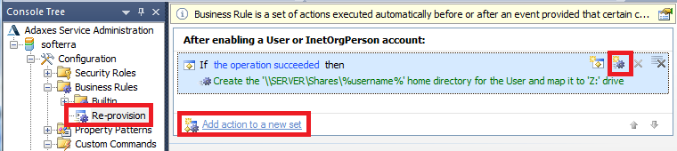

  1. In the Console Tree, navigate to and select the Business Rule that re-provisions users.
  2. Select a set of actions and conditions and click the Add Action button or click the Add action to a new set link if you want to create a new action/condition set.
