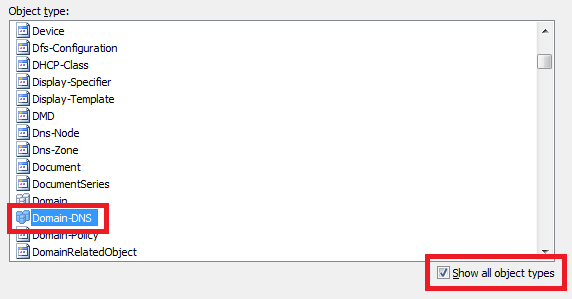

To create a Scheduled Task that generates a report on disabled managers in all domains managed by Adaxes:
  2. On the 3rd step of the Create Scheduled Task wizard, select the Show all object types option.
  3. Select the Domain-DNS object type. Running the Task on a domain allows to run the script only once per a Task run.

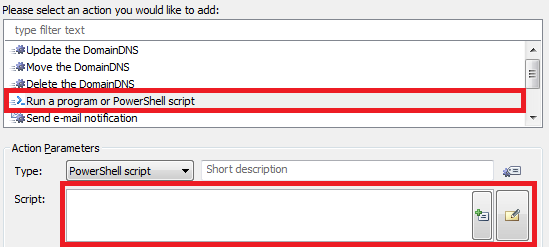

  4. On the 4th step of the wizard, add the Run a program or PowerShell script action and paste the following script in the Script field.

  5. In the script $to specifies the e-mail address of the recipient to whom the report will be sent. Modify it as necessary.
  6. Add a short description for the script and click OK.
