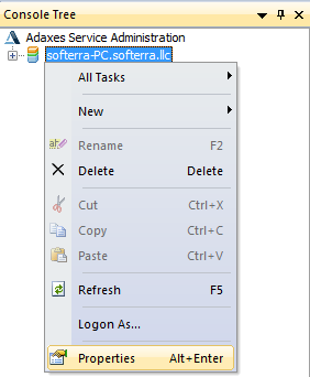

  2. In the Console Tree, right-click the service node for your Adaxes service.
  3. Click Properties.

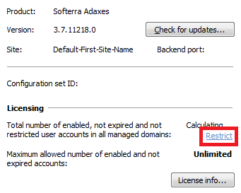

  4. Click Restrict.

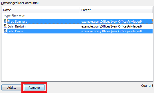

  5. Select the users you want to manage with Adaxes.
  6. Click Remove.
  7. Click Yes, and then click OK 2 times.

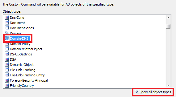

  2. On the 3rd step of the Create Scheduled Task wizard, select Show all object types and select the Domain-DNS object type. Running a task on a domain allows you to run the script only once per a task run.

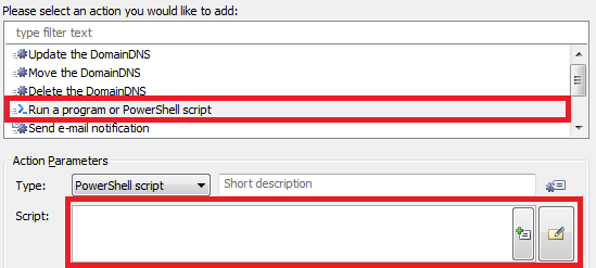

  3. On the 3rd step, add the Run a program or PowerShell script action and paste the following script in the Script field.

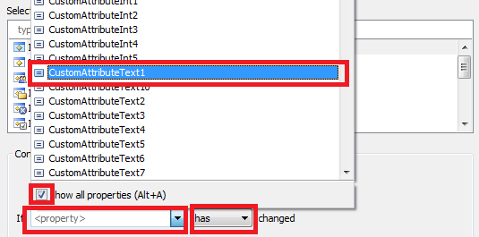

  6. Now, you need to add a condition when the script will be executed. Right-click the action that you've just added and select Add Condition.
  7. Select the If <property> <changed> condition type.
  8. In the <property> drop-down list, select Show all properties and select the virtual attribute that you chose, e.g. CustomAttributeText1.
  9. Select has changed.
  10. Click OK.

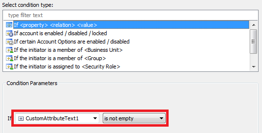

  11. Also, the script to must be launched only when an account is specified, that is, when the virtual attribute is not empty. Right-click the action that you've added and select Add Condition again.
  12. Select the If <property> <relation> <value> condition type.
  13. In the <property> drop-down list, select Show all properties and select the virtual property that you chose, e.g. CustomAttributeText1.
  14. Select is not empty.
  15. Click OK.
