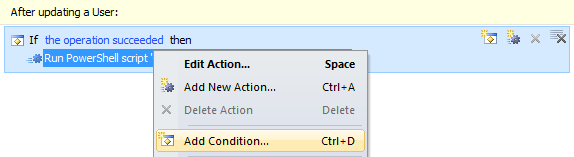

  6. Now, you need to specify when the script will be run. For this purpose, you need to add conditions. Right-click the action that you've just added and click ​Add Condition​.

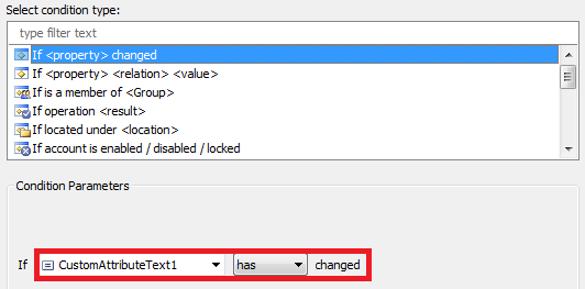

  7. Select the ​If <property> changed​ condition type.
  8. Specify ​If ​CustomAttributeText1 has changed, where CustomAttributeText1 is the name of the property that will be used to pass the project name.
  9. Click ​OK​.

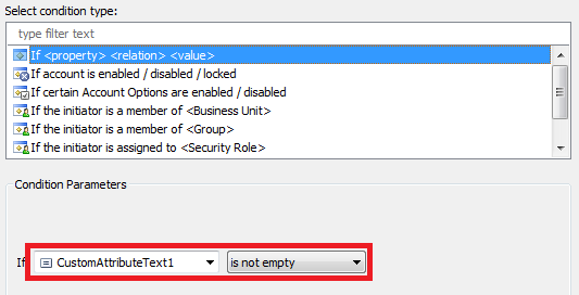

  12. Specify If CustomAttributeText1 is not empty, where CustomAttributeText1 is the name of the property that will be used to pass the project name.
  13. Click ​OK​.

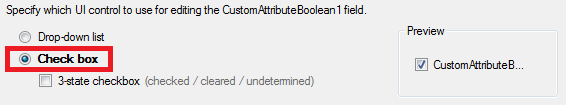

To allow selecting whether it is necessary to create an administrator account for new users, you can add a boolean attribute to the page that is used for creating new users. The attribute will be used as a flag to indicate whether it is necessary to create an administrator account. For information on how to add a field to the page for creating new users, see step 6 of the following tutorial: http://www.adaxes.com/tutorials_WebInte ... tomization. As soon as you add a boolean attribute to the page, you'll need to specify how it will be displayed on the page. You can select to display the attribute as a checkbox for convenience.

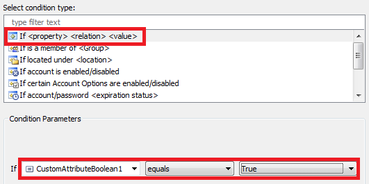

As for an attribute that you can use as a flag, you can use one of Adaxes custom attributes that can store boolean (true/false) values, for example, CustomAttributeBoolean1. This attribute is not stored in AD, but can be used the same as any other attributes of AD objects.
To automatically create administrator accounts for users who have the attribute set to True, you need to configure a Business Rule that will execute the Custom Command for new administrative accounts. To configure such a Business Rule:
  2. On step 2 of the Create Business Rule wizard, select User and After Creating a User.

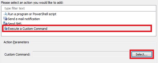

  3. On step 3, add the Execute a Custom Command action and click Select.
  4. Select the Custom Command that you've created for enabling administrative accounts.
  5. Click OK.

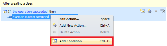

  6. Right-click the action you've just added and click Add Condition.
  7. Select the If <property> <relation> <value> condition.
  8. Specify If CustomAttributeBoolean1 equals True, where CustomAttributeBoolean1 is the boolean attribute that is used as a flag to mark administrative accounts.
  9. Click OK and finish creation of the Business Rule.
